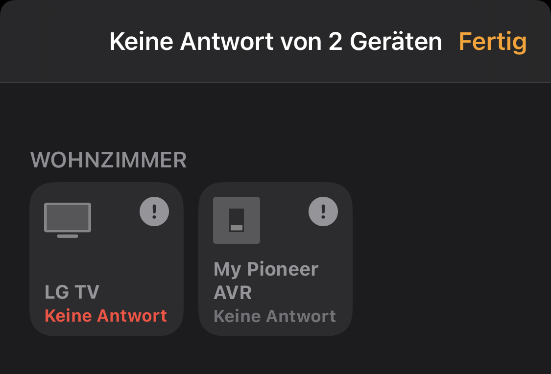

Wenn ich das Plugin installiert habe, dann stoppt die Homebridge mit folgendem Log:
Alles anzeigen[20/02/2021, 19:02:28] Loaded plugin: @drlocoh/[email protected] [20/02/2021, 19:02:28] Registering accessory '@drlocoh/homebridge-pioneer-vsx527.pioneerVSX527Accessory' [20/02/2021, 19:02:31] Loading 1 accessories... [20/02/2021, 19:02:31] Error loading accessory requested in your config.json at position 1 [20/02/2021, 19:02:31] Error: The requested accessory 'pioneerVsx527Accessory' was not registered by any plugin. at PluginManager.getPluginForAccessory (/usr/local/lib/node_modules/homebridge/src/pluginManager.ts:198:15) at /usr/local/lib/node_modules/homebridge/src/server.ts:347:37 at Array.forEach (<anonymous>) at Server._loadAccessories (/usr/local/lib/node_modules/homebridge/src/server.ts:330:29) at Server.start (/usr/local/lib/node_modules/homebridge/src/server.ts:156:12) at cli (/usr/local/lib/node_modules/homebridge/src/cli.ts:80:10) at Object.<anonymous> (/usr/local/lib/node_modules/homebridge/bin/homebridge:17:22) at Module._compile (internal/modules/cjs/loader.js:1063:30) at Object.Module._extensions..js (internal/modules/cjs/loader.js:1092:10) at Module.load (internal/modules/cjs/loader.js:928:32) [20/02/2021, 19:02:31] Got SIGTERM, shutting down Homebridge...

LG Connect Apps habe ich enabled
ich verstehe das Thema nicht... habe so viel rumgetestet und komme nicht weiter... *murks
