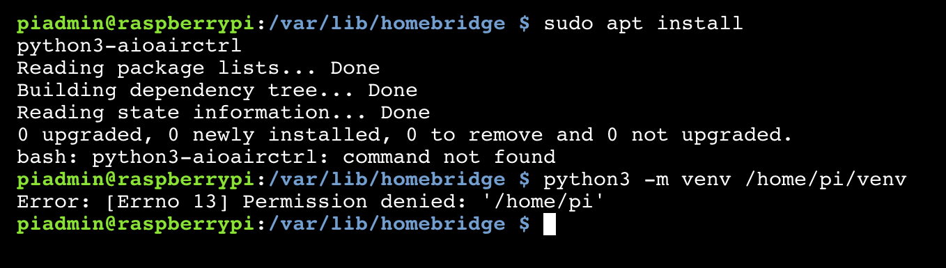

    piadmin@raspberrypi:/var/lib/homebridge $ python3 -m venv /home/piadmin/venv.
    /home/piadmin/venv/bin/pip3 install -U git+https://github.com/Peter-J/aioairctrl
    Looking in indexes: https://pypi.org/simple, https://www.piwheels.org/simple
    Collecting git+https://github.com/Peter-J/aioairctrl
    Cloning https://github.com/Peter-J/aioairctrl to /tmp/pip-req-build-2mk20gvv
    Running command git clone --filter=blob:none --quiet https://github.com/Peter-J/aioairctrl /tmp/pip-req-build-2mk20gvv
    Resolved https://github.com/Peter-J/aioairctrl to commit d9084783c6750b2b25e65cd551efe3442e652b09
    Installing build dependencies ... done
    Getting requirements to build wheel ... done
    Preparing metadata (pyproject.toml) ... done
    Requirement already satisfied: aiocoap==0.4.1 in /home/piadmin/venv/lib/python3.11/site-packages (from aioairctrl==0.2.1) (0.4.1)
    Requirement already satisfied: pycryptodomex in /home/piadmin/venv/lib/python3.11/site-packages (from aioairctrl==0.2.1) (3.23.0)

    piadmin@raspberrypi:/var/lib/homebridge $ sudo apt install python3-pip git
    Reading package lists... Done
    Building dependency tree... Done
    Reading state information... Done
    python3-pip is already the newest version (23.0.1+dfsg-1+rpt1).
    git is already the newest version (1:2.39.5-0+deb12u1).
    0 upgraded, 0 newly installed, 0 to remove and 0 not upgraded.
    Sorry, nein, Missverständnis!
    Wenn ich das mache: sudo pip3 install -U git+https://github.com/Peter-J/aioairctrl
    Komm tauch wieder das:
    error: externally-managed-environment
    × This environment is externally managed
    ╰─> To install Python packages system-wide, try apt install
    python3-xyz, where xyz is the package you are trying to
    install.
    If you wish to install a non-Debian-packaged Python package,
    create a virtual environment using python3 -m venv path/to/venv.
    Then use path/to/venv/bin/python and path/to/venv/bin/pip. Make
    sure you have python3-full installed.
    For more information visit http://rptl.io/venv
    note: If you believe this is a mistake, please contact your Python installation or OS distribution provider. You can override this, at the risk of breaking your Python installation or OS, by passing --break-system-packages.
    hint: See PEP 668 for the detailed specification.
    Wenn mir hier jemand helfen würde, kann ich die Schritte gerne durchführen, aber so alleine verstehe ich nicht ganz, was zu tun ist.
