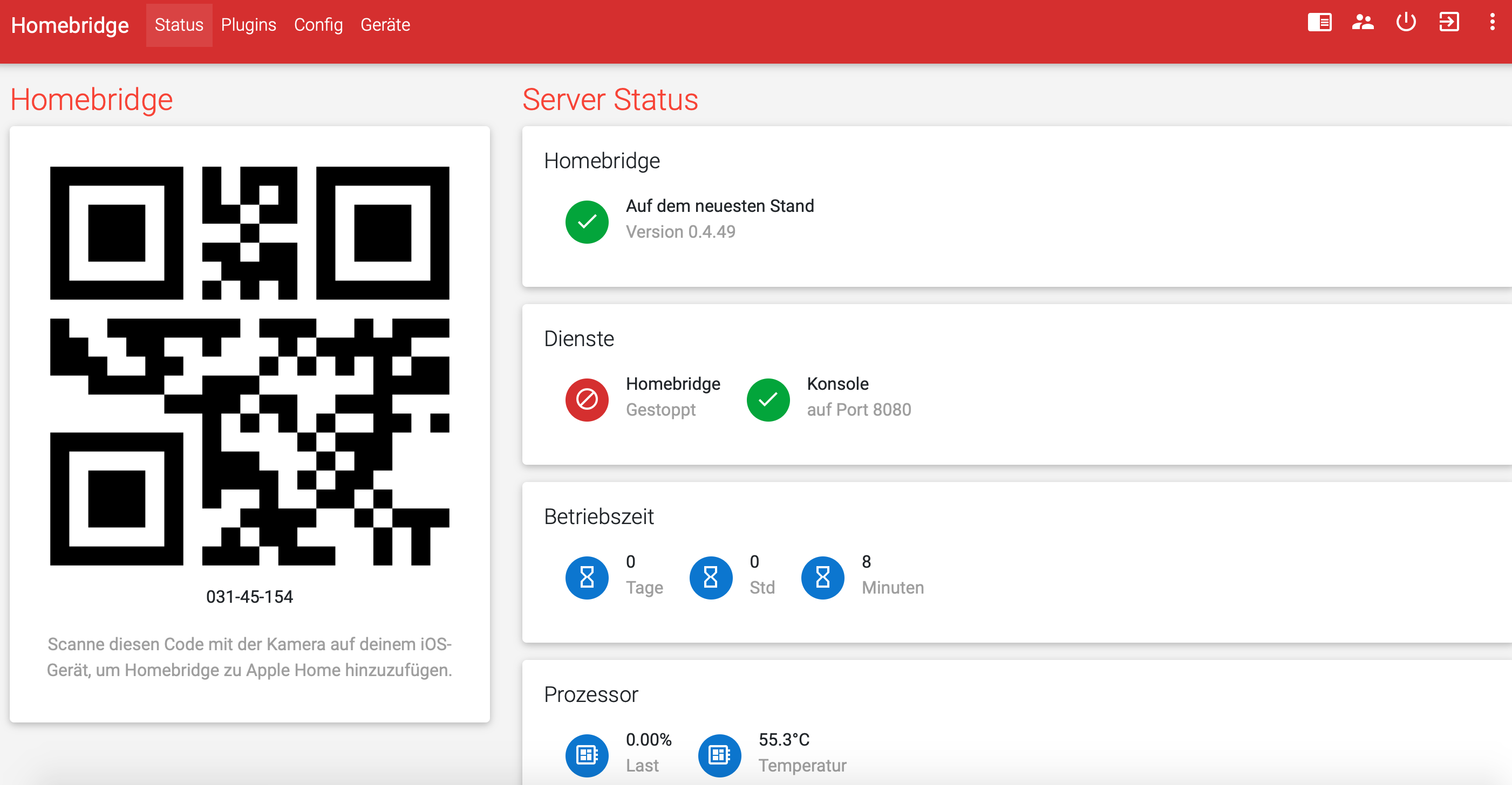

    Wenn ich nun die IP im browser eingebe und mich mit "admin" und "admin" anmelde steht da, dass die Homebridge nicht startet.
    Was kann ich da machen?

    OK....das hat geklappt. Das sieht dann so aus und es wiederholt sich ständig. Ich denke mal er startet dauernd neu oder?
    pi@raspberrypi:~ $ sudo journalctl -fau homebridge
    -- Logs begin at Tue 2019-05-14 11:37:56 CEST. --
    May 14 22:41:37 raspberrypi homebridge[25854]: at Object.<anonymous> (/usr/local/lib/node_modules/homebridge/bin/homebridge:17:22)
    May 14 22:41:37 raspberrypi homebridge[25854]: at Module._compile (internal/modules/cjs/loader.js:701:30)
    May 14 22:41:37 raspberrypi homebridge[25854]: at Object.Module._extensions..js (internal/modules/cjs/loader.js:712:10)
    May 14 22:41:37 raspberrypi homebridge[25854]: at Module.load (internal/modules/cjs/loader.js:600:32)
    May 14 22:41:37 raspberrypi homebridge[25854]: at tryModuleLoad (internal/modules/cjs/loader.js:539:12)
    May 14 22:41:37 raspberrypi homebridge[25854]: at Function.Module._load (internal/modules/cjs/loader.js:531:3)
    May 14 22:41:37 raspberrypi homebridge[25854]: at Function.Module.runMain (internal/modules/cjs/loader.js:754:12)
    May 14 22:41:37 raspberrypi homebridge[25854]: at startup (internal/bootstrap/node.js:283:19)
    May 14 22:41:37 raspberrypi homebridge[25854]: at bootstrapNodeJSCore (internal/bootstrap/node.js:622:3)
    May 14 22:41:37 raspberrypi homebridge[25854]: [5/14/2019, 10:41:37 PM] Got SIGTERM, shutting down Homebridge...
    May 14 22:41:42 raspberrypi systemd[1]: homebridge.service: Main process exited, code=exited, status=143/n/a
    May 14 22:41:42 raspberrypi systemd[1]: homebridge.service: Unit entered failed state.
    May 14 22:41:42 raspberrypi systemd[1]: homebridge.service: Failed with result 'exit-code'.
    May 14 22:41:52 raspberrypi systemd[1]: homebridge.service: Service hold-off time over, scheduling restart.
    May 14 22:41:52 raspberrypi systemd[1]: Stopped Node.js HomeKit Server.
    May 14 22:41:52 raspberrypi systemd[1]: Started Node.js HomeKit Server.
    May 14 22:41:55 raspberrypi homebridge[25892]: [5/14/2019, 10:41:55 PM] Loaded config.json with 0 accessories and 2 platforms.
    May 14 22:41:55 raspberrypi homebridge[25892]: [5/14/2019, 10:41:55 PM] ---
    May 14 22:41:55 raspberrypi homebridge[25892]: [5/14/2019, 10:41:55 PM] Loaded plugin: homebridge-config-ui-x
    May 14 22:41:55 raspberrypi homebridge[25892]: [5/14/2019, 10:41:55 PM] Registering platform 'homebridge-config-ui-x.config'
    May 14 22:41:55 raspberrypi homebridge[25892]: [5/14/2019, 10:41:55 PM] Loaded plugin: homebridge-fritz
    May 14 22:41:57 raspberrypi homebridge[25892]: [5/14/2019, 10:41:57 PM] Registering platform 'homebridge-fritz.Fritz!Box'
    May 14 22:41:57 raspberrypi homebridge[25892]: [5/14/2019, 10:41:57 PM] ---
    May 14 22:41:57 raspberrypi homebridge[25892]: [5/14/2019, 10:41:57 PM] Loading 2 platforms...
    May 14 22:41:57 raspberrypi homebridge[25892]: [5/14/2019, 10:41:57 PM] [Config] Initializing config platform...
    May 14 22:41:57 raspberrypi homebridge[25892]: [5/14/2019, 10:41:57 PM] [Config] Spawning homebridge-config-ui-x with PID 25912
    May 14 22:41:57 raspberrypi homebridge[25892]: [5/14/2019, 10:41:57 PM] TypeError: Cannot read property 'indexOf' of undefined
    May 14 22:41:57 raspberrypi homebridge[25892]: at API.platform (/usr/local/lib/node_modules/homebridge/lib/api.js:120:12)
    May 14 22:41:57 raspberrypi homebridge[25892]: at Server._loadPlatforms (/usr/local/lib/node_modules/homebridge/lib/server.js:327:45)
    May 14 22:41:57 raspberrypi homebridge[25892]: at Server.run (/usr/local/lib/node_modules/homebridge/lib/server.js:90:36)
    May 14 22:41:57 raspberrypi homebridge[25892]: at module.exports (/usr/local/lib/node_modules/homebridge/lib/cli.js:59:10)
    May 14 22:41:57 raspberrypi homebridge[25892]: at Object.<anonymous> (/usr/local/lib/node_modules/homebridge/bin/homebridge:17:22)
    May 14 22:41:57 raspberrypi homebridge[25892]: at Module._compile (internal/modules/cjs/loader.js:701:30)
    May 14 22:41:57 raspberrypi homebridge[25892]: at Object.Module._extensions..js (internal/modules/cjs/loader.js:712:10)
    May 14 22:41:57 raspberrypi homebridge[25892]: at Module.load (internal/modules/cjs/loader.js:600:32)
    May 14 22:41:57 raspberrypi homebridge[25892]: at tryModuleLoad (internal/modules/cjs/loader.js:539:12)
    May 14 22:41:57 raspberrypi homebridge[25892]: at Function.Module._load (internal/modules/cjs/loader.js:531:3)
    May 14 22:41:57 raspberrypi homebridge[25892]: at Function.Module.runMain (internal/modules/cjs/loader.js:754:12)
    May 14 22:41:57 raspberrypi homebridge[25892]: at startup (internal/bootstrap/node.js:283:19)
    May 14 22:41:57 raspberrypi homebridge[25892]: at bootstrapNodeJSCore (internal/bootstrap/node.js:622:3)
    May 14 22:41:57 raspberrypi homebridge[25892]: [5/14/2019, 10:41:57 PM] Got SIGTERM, shutting down Homebridge...
    May 14 22:42:02 raspberrypi systemd[1]: homebridge.service: Main process exited, code=exited, status=143/n/a
    May 14 22:42:02 raspberrypi systemd[1]: homebridge.service: Unit entered failed state.
    May 14 22:42:02 raspberrypi systemd[1]: homebridge.service: Failed with result 'exit-code'.
    May 14 22:42:12 raspberrypi systemd[1]: homebridge.service: Service hold-off time over, scheduling restart.
