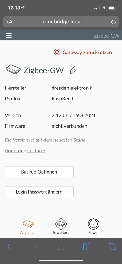

pi@homebridge:~ $ sudo systemctl stop ModemManager
pi@homebridge:~ $ sudo GCFFlasher_internal -t 60 -f deCONZ_RaspBeeII_0x26720700.bin.GCF
GCFFlasher V3_17 (c) dresden elektronik ingenieurtechnik gmbh
Reboot device RaspBee (RaspBee)
deCONZ firmware version 26690700
failed reset 19996
action: reset device RaspBee
wiringPi 2.52 initialized
Bootloader version 0x00030003, app crc: 0x93C2CD88
flashing 164227 bytes: |=Reboot device RaspBee (RaspBee)
retry, failed
