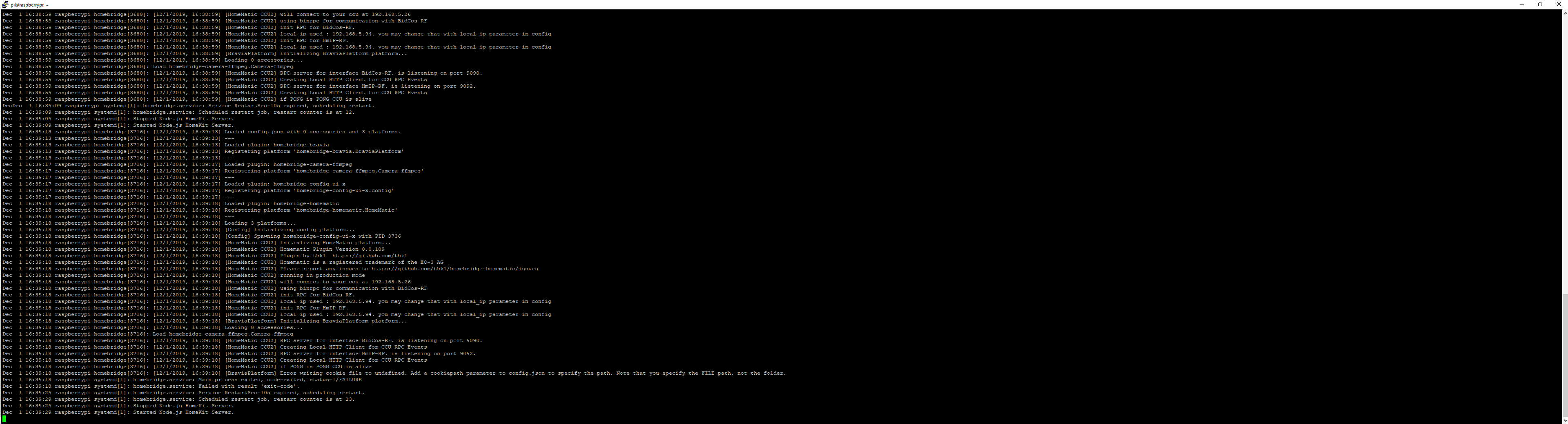

Dec 03 19:45:22 raspberrypi homebridge[29942]: [12/3/2019, 19:45:22] [BraviaPlatform] Error writing cookie file to undefined. Add a cookiepath parameter to config.json to specify the path. Note that you specify the FILE path, not the folder.
Dec 03 19:45:22 raspberrypi systemd[1]: homebridge.service: Main process exited, code=exited, status=1/FAILURE
Dec 03 19:45:22 raspberrypi systemd[1]: homebridge.service: Failed with result 'exit-code'.
Dec 03 19:45:32 raspberrypi systemd[1]: homebridge.service: Service RestartSec=10s expired, scheduling restart.
Dec 03 19:45:32 raspberrypi systemd[1]: homebridge.service: Scheduled restart job, restart counter is at 1.
Dec 03 19:45:32 raspberrypi systemd[1]: Stopped Node.js HomeKit Server.
Dec 03 19:45:32 raspberrypi systemd[1]: Started Node.js HomeKit Server.

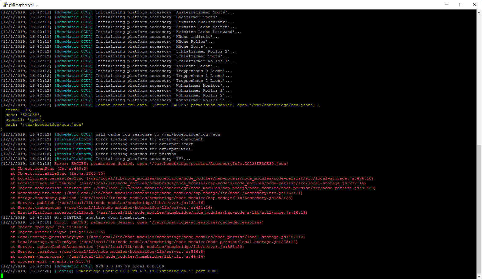

Alles anzeigenStarted Node.js HomeKit Server. internal/fs/utils.js:220 throw err; ^ Error: EACCES: permission denied, open '/var/homebridge/persist/AccessoryInfo.26A794509F02.json' at Object.openSync (fs.js:440:3) at Object.readFileSync (fs.js:342:35) at LocalStorage.parseDirSync (/usr/local/lib/node_modules/homebridge/node_modules/hap-nodejs/node_modules/node-persist/src/local-storage.js:637:35) at LocalStorage.parseDataDirSync (/usr/local/lib/node_modules/homebridge/node_modules/hap-nodejs/node_modules/node-persist/src/local-storage.js:572:21) at LocalStorage.initSync (/usr/local/lib/node_modules/homebridge/node_modules/hap-nodejs/node_modules/node-persist/src/local-storage.js:145:14) at Object.nodePersist.initSync (/usr/local/lib/node_modules/homebridge/node_modules/hap-nodejs/node_modules/node-persist/src/node-persist.js:41:29) at Object.init (/usr/local/lib/node_modules/homebridge/node_modules/hap-nodejs/index.js:31:13) at module.exports (/usr/local/lib/node_modules/homebridge/lib/cli.js:30:7) at Object.<anonymous> (/usr/local/lib/node_modules/homebridge/bin/homebridge:17:22) at Module._compile (internal/modules/cjs/loader.js:956:30) { errno: -13, syscall: 'open', code: 'EACCES', path: '/var/homebridge/persist/AccessoryInfo.26A794509F02.json' } homebridge.service: Main process exited, code=exited, status=1/FAILURE homebridge.service: Failed with result 'exit-code'. homebridge.service: Service RestartSec=10s expired, scheduling restart. homebridge.service: Scheduled restart job, restart counter is at 950. Stopped Node.js HomeKit Server. Started Node.js HomeKit Server. internal/fs/utils.js:220 throw err; ^ Error: EACCES: permission denied, open '/var/homebridge/persist/AccessoryInfo.26A794509F02.json' at Object.openSync (fs.js:440:3) at Object.readFileSync (fs.js:342:35) at LocalStorage.parseDirSync (/usr/local/lib/node_modules/homebridge/node_modules/hap-nodejs/node_modules/node-persist/src/local-storage.js:637:35) at LocalStorage.parseDataDirSync (/usr/local/lib/node_modules/homebridge/node_modules/hap-nodejs/node_modules/node-persist/src/local-storage.js:572:21) at LocalStorage.initSync (/usr/local/lib/node_modules/homebridge/node_modules/hap-nodejs/node_modules/node-persist/src/local-storage.js:145:14) at Object.nodePersist.initSync (/usr/local/lib/node_modules/homebridge/node_modules/hap-nodejs/node_modules/node-persist/src/node-persist.js:41:29) at Object.init (/usr/local/lib/node_modules/homebridge/node_modules/hap-nodejs/index.js:31:13) at module.exports (/usr/local/lib/node_modules/homebridge/lib/cli.js:30:7) at Object.<anonymous> (/usr/local/lib/node_modules/homebridge/bin/homebridge:17:22) at Module._compile (internal/modules/cjs/loader.js:956:30) { errno: -13, syscall: 'open', code: 'EACCES', path: '/var/homebridge/persist/AccessoryInfo.26A794509F02.json' }

Alles anzeigen[12/1/2019, 16:33:07] [HomeMatic CCU2] Initializing platform accessory 'Treppenhaus 0 Licht'... [12/1/2019, 16:33:07] [HomeMatic CCU2] Initializing platform accessory 'Treppenhaus 1 Licht'... [12/1/2019, 16:33:07] [HomeMatic CCU2] Initializing platform accessory 'Treppenhaus 2 Licht'... [12/1/2019, 16:33:07] [HomeMatic CCU2] Initializing platform accessory 'Wohnzimmer Monitor'... [12/1/2019, 16:33:07] [HomeMatic CCU2] Initializing platform accessory 'Wohnzimmer Rollos 1'... [12/1/2019, 16:33:07] [HomeMatic CCU2] Initializing platform accessory 'Wohnzimmer Rollos 2'... [12/1/2019, 16:33:07] [HomeMatic CCU2] Initializing platform accessory 'Wohnzimmer Rollos 3'... [12/1/2019, 16:33:07] [HomeMatic CCU2] Cannot cache ccu data [Error: EACCES: permission denied, open '/var/homebridge/ccu.json'] { errno: -13, code: 'EACCES', syscall: 'open', path: '/var/homebridge/ccu.json' } [12/1/2019, 16:33:07] [HomeMatic CCU2] will cache ccu response to /var/homebridge/ccu.json 6000 [12/1/2019, 16:33:08] [BraviaPlatform] Added input HDMI 1 [12/1/2019, 16:33:08] [BraviaPlatform] Added input HDMI 2 [12/1/2019, 16:33:08] [BraviaPlatform] Added input HDMI 3 (eARC/ARC) [12/1/2019, 16:33:08] [BraviaPlatform] Added input HDMI 4 [12/1/2019, 16:33:08] [BraviaPlatform] Error loading sources for extInput:component [12/1/2019, 16:33:08] [BraviaPlatform] Error loading sources for extInput:scart [12/1/2019, 16:33:09] [BraviaPlatform] Error loading sources for extInput:widi [12/1/2019, 16:33:09] [BraviaPlatform] Error loading sources for tv:dvbs [12/1/2019, 16:33:09] [BraviaPlatform] Initializing platform accessory 'TV'... [12/1/2019, 16:33:09] Error: EACCES: permission denied, open '/var/homebridge/persist/AccessoryInfo.CC223DE3CE30.json' at Object.openSync (fs.js:440:3) at Object.writeFileSync (fs.js:1265:35) at LocalStorage.persistKeySync (/usr/local/lib/node_modules/homebridge/node_modules/hap-nodejs/node_modules/node-persist/src/local-storage.js:476:16) at LocalStorage.setItemSync (/usr/local/lib/node_modules/homebridge/node_modules/hap-nodejs/node_modules/node-persist/src/local-storage.js:277:14) at Object.nodePersist.setItemSync (/usr/local/lib/node_modules/homebridge/node_modules/hap-nodejs/node_modules/node-persist/src/node-persist.js:99:29) at AccessoryInfo.save (/usr/local/lib/node_modules/homebridge/node_modules/hap-nodejs/lib/model/AccessoryInfo.js:163:11) at Bridge.Accessory.publish (/usr/local/lib/node_modules/homebridge/node_modules/hap-nodejs/lib/Accessory.js:552:23) at Server._publish (/usr/local/lib/node_modules/homebridge/lib/server.js:132:16) at Server.<anonymous> (/usr/local/lib/node_modules/homebridge/lib/server.js:421:14) at BraviaPlatform.accesoryCallback (/usr/local/lib/node_modules/homebridge/node_modules/hap-nodejs/lib/util/once.js:16:19) [12/1/2019, 16:33:09] Got SIGTERM, shutting down Homebridge... [12/1/2019, 16:33:09] Error: EACCES: permission denied, open '/var/homebridge/accessories/cachedAccessories' at Object.openSync (fs.js:440:3) at Object.writeFileSync (fs.js:1265:35) at LocalStorage.persistKeySync (/usr/local/lib/node_modules/homebridge/node_modules/node-persist/local-storage.js:457:12) at LocalStorage.setItemSync (/usr/local/lib/node_modules/homebridge/node_modules/node-persist/local-storage.js:275:14) at Server._updateCachedAccessories (/usr/local/lib/node_modules/homebridge/lib/server.js:581:20) at Server._teardown (/usr/local/lib/node_modules/homebridge/lib/server.js:586:8) at process.<anonymous> (/usr/local/lib/node_modules/homebridge/lib/cli.js:44:14) at process.emit (events.js:215:7) [12/1/2019, 16:33:10] [Config] Homebridge Config UI X v4.6.4 is listening on :: port 8080 [12/1/2019, 16:33:13] [HomeMatic CCU2] NPM 0.0.109 vs Local 0.0.109

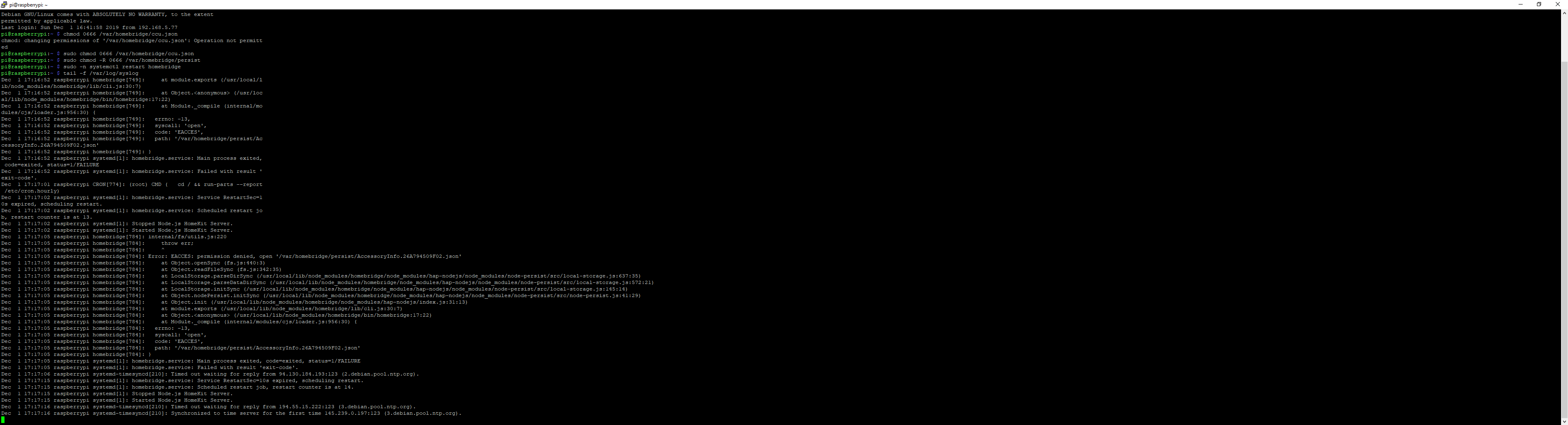

und "tail -f /var/log/syslog" bringt jetzt folgendes:

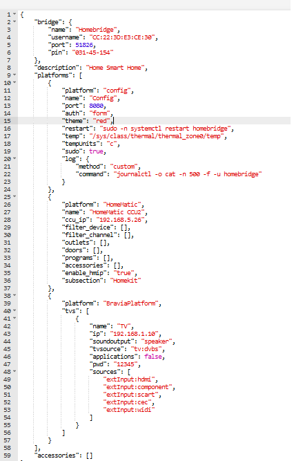

Wenn ich das so mache wie in der Anleitung, dann zeigt der TV mir KEINEN Pin Code an. Also wenn ich über die console per "homebridge" die Applikation starte. Nur, wenn ich die App per Systemdienst starte (oder eben den Raspi resette). So, dann bootet der Rasp, der TV zeigt mir auch die PIN an. Die trage ich dann flott in die Config ein und starte den Rasp neu. der TV meldet dann auch, dass die Remote verbunden ist, aber der rasp hängt sich dann scheinbar auf. Bzw. homebridge tut das. per SSH komme ich dann noch drauf, aber er stratet die bridge nicht mehr. Komme auch nicht mehr ins Web Interface. Erst, wenn ich den kompletten Blog aus der config.json per nano aufm Terminal wieder rausnehme, kann ich die Bridge wieder starten.
Die Config sieht wie folgt aus:
Laut Validation ist der code korrekt.

Die IP ist jetzt nicht die korrekte im Screenshot - bei meinen Tests war sie es aber. Wie gesagt, der TV reagiert ja auch darauf.
