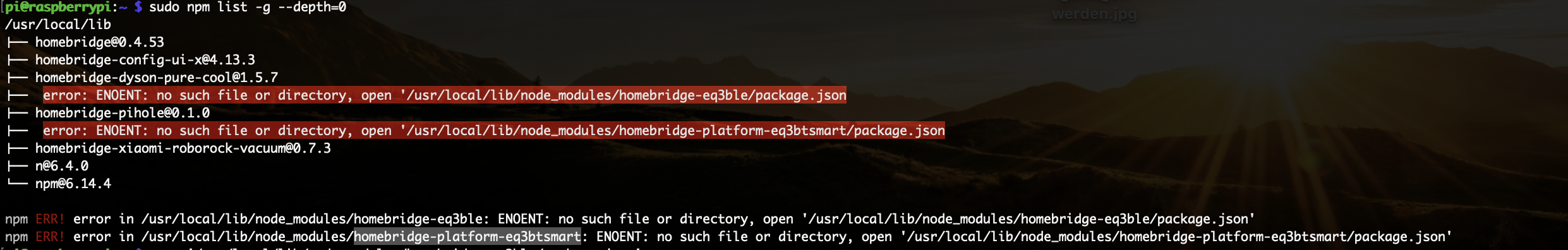

Hier habe ich nun das Log und hoffe, dass ich alles richtig gemacht habe...
pi@raspberrypi:~ $ sudo systemctl restart homebridge; sudo journalctl -fau homebridge

Apr 05 11:16:58 raspberrypi homebridge[6170]: [05/04/2020, 11:16:58] Plugin /usr/local/lib/node_modules/homebridge-eq3ble does not contain a package.json.
Apr 05 11:16:58 raspberrypi homebridge[6170]: [05/04/2020, 11:16:58] Plugin /usr/local/lib/node_modules/homebridge-platform-eq3btsmart does not contain a package.json.
