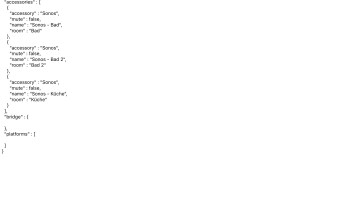

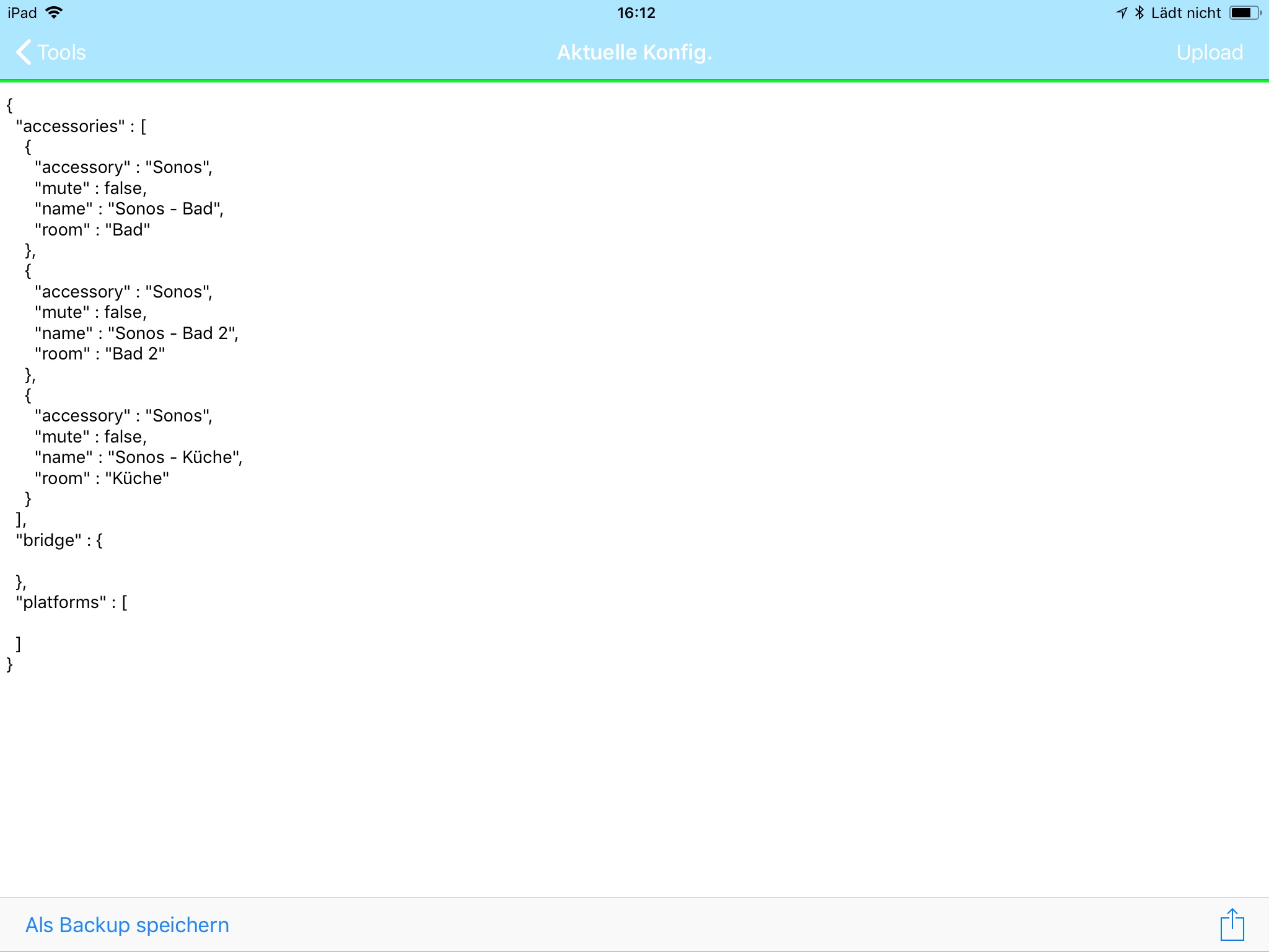

    "bridge": {
    "name": "Homebridge",
    "port": 51826,
    "pin": "031-45-154"
    "accessories": [
    "accessory": "Sonos",
    "name": "Bad SONOS",
    "room": "Bad",
    "mute": false
    "name": "Bad 2 SONOS",
    "room": "Bad 2",
    "mute": false
    "name": "Küche SONOS",
    "room": "Küche",
    "mute": false
