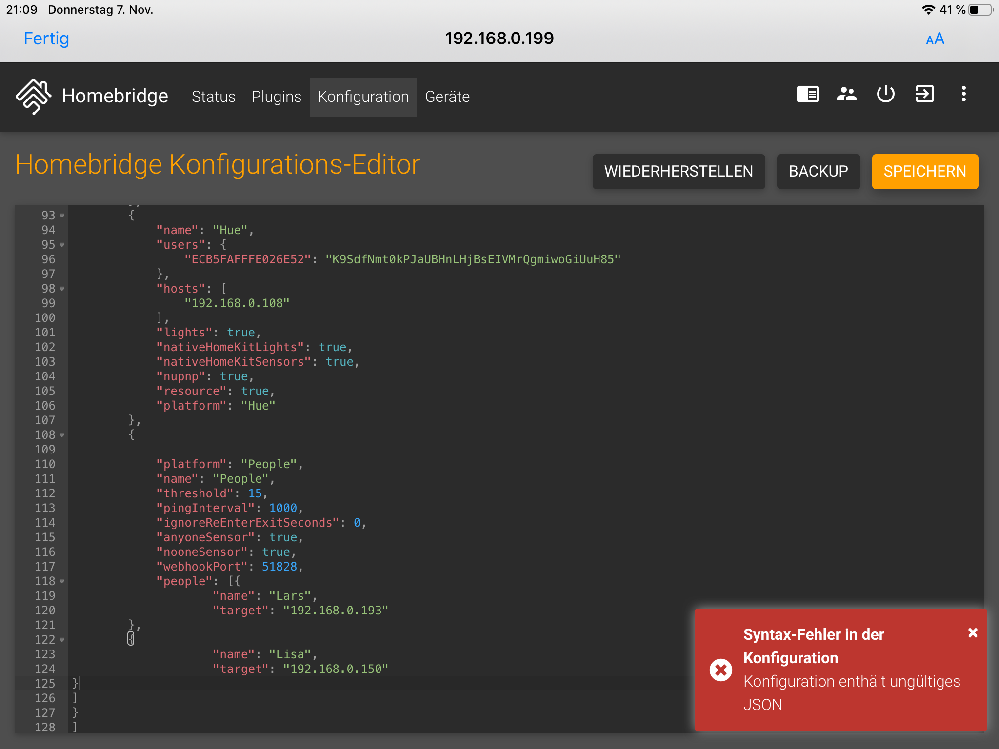

    so hier mal die config
    "bridge": {
    "name": "Homebridge",
    "username": "CC:22:3D:E3:CE:31",
    "port": 51826,
    "pin": "031-45-154"
    "accessories": [{
    "name": "Xiaomi Mi Robot Vaccum 2st Generation",
    "ip": "192.168.0.180",
    "token": "6f7a59594a3347646e334c667a4a4f53",
    "pause": true,
    "dock": true,
    "accessory": "XiaomiRoborockVacuum"
    "platforms": [{
    "name": "Config",
    "port": 8080,
    "auth": "form",
    "theme": "dark-mode",
    "tempUnits": "c",
    "sudo": true,
    "log": {
    "method": "custom",
    "platform": "config"
    "platform": "NukiBridge",
    "bridge_url": "192.168.0.94:8080",
    "api_token": "XmjeUQ",
    "cache_directory": "./.node-persist/storage",
    "locks": [{
    "id": "14BCEF25",
    "name": "Wohnungstür",
    "usesDoorLatch": true
    "platform": "SoundTouchPlatform",
    "name": "SoundTouch",
    "accessories": [{
    "name": "Bose Soundtouch Küche",
    "ip": "192.168.0.59",
    "onVolume": 10,
    "unmuteVolume": 30,
    "source": "true",
    "volume": {
    "mode": "lightbulb"
    "presets": [{
    "index": 1,
    "name": "Dies&Das"
    "index": 2,
    "name": "SWR 3"
    "index": 3,
    "name": "big fm"
    "global": {
    "sources": [{
    "source": "QPLAY",
    "enabled": false
    "source": "AUX",
    "enabled": false
    "source": "BLUETOOTH",
    "enabled": false
    "name": "Hue",
    "users": {
    "ECB5FAFFFE026E52": "K9SdfNmt0kPJaUBHnLHjBsEIVMrQgmiwoGiUuH85"
    "hosts": [
    "192.168.0.108"
    "lights": true,
    "nativeHomeKitLights": true,
    "nativeHomeKitSensors": true,
    "nupnp": true,
    "resource": true,
    "platform": "Hue"
    "platform": "People",
    "name": "People",
    "threshold": 15,
    "pingInterval": 1000,
    "ignoreReEnterExitSeconds": 0,
    "anyoneSensor": true,
    "nooneSensor": true,
    "webhookPort": 51828,
    "people": [{
    "name": "Lars",
    "target": "192.168.0.193"
    "name": "Lisa",
    "target": "192.168.0.150"
    wo ist der Fehler
    Also ich konnte über termius meine config anzeigen lassen, den Inhalt markieren, kopieren und bei jsonlint einfügen und prüfen lassen.
    sudo cat /var/homebridge/config.json
    okay klappt irgendwie nicht bei mir dann muss ich es wohl doch mal am pc versuchen
    ja schon da ich leider keinen mac besitze und immer pc hochfahren das ist nervig da die Kiste leider schon ein wenig in die Jahre gekommen ist.
    Kann ich es nicht irgendwie raus kopieren
    ja ist zu Ende aber klappt trotzdem nicht 🙄
