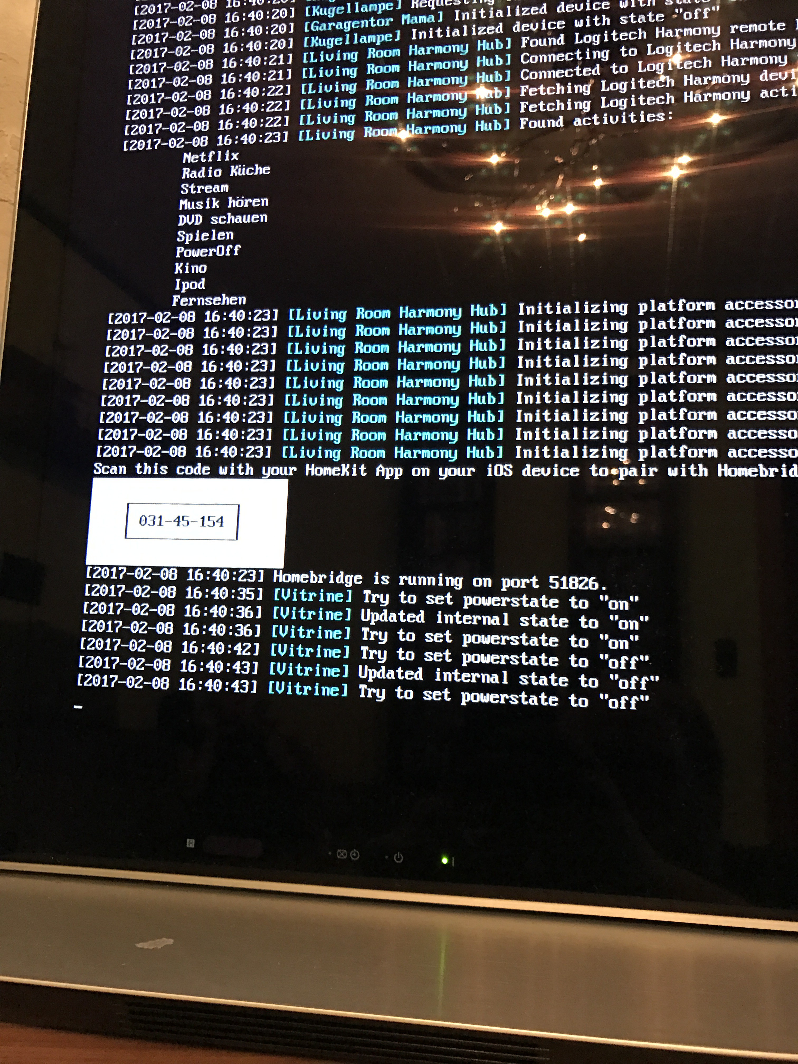

"bridge": {
"name": "Apple Server",
"username": "CC:22:3D:E3:CE:40",
"port": 51826,
"pin": "031-45-154"
"accessories": [
"accessory": "pilight",
"name": "Scheinwerfer",
"device": "Switch2",
"sharedWS": false,
"type": "Switch"
"name": "Vitrine",
"device": "Switch4",
"sharedWS": false,
"type": "Switch"
"name": "Garagentor Mama",
"device": "Switch3",
"sharedWS": true,
"type": "Switch"
"name": "Kugellampe",
"device": "Switch1",
"sharedWS": false,
"type": "Switch"
"platforms": [
"platform": "HarmonyHub",
"name": "Living Room Harmony Hub"
