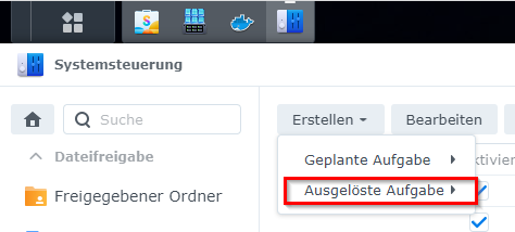

- Connect to your NAS via SSH (I suggest using Putty), login with your credentials.
- Type "sudo su" in order to have Super User Permissions (after pressing enter it will ask you for the password again).
- Run following commands in order
- modprobe usbserial
- modprobe ftdi_sio
- modprobe cdc-acm
- Unplug Conbee 2 stick from your NAS and plug it back in.

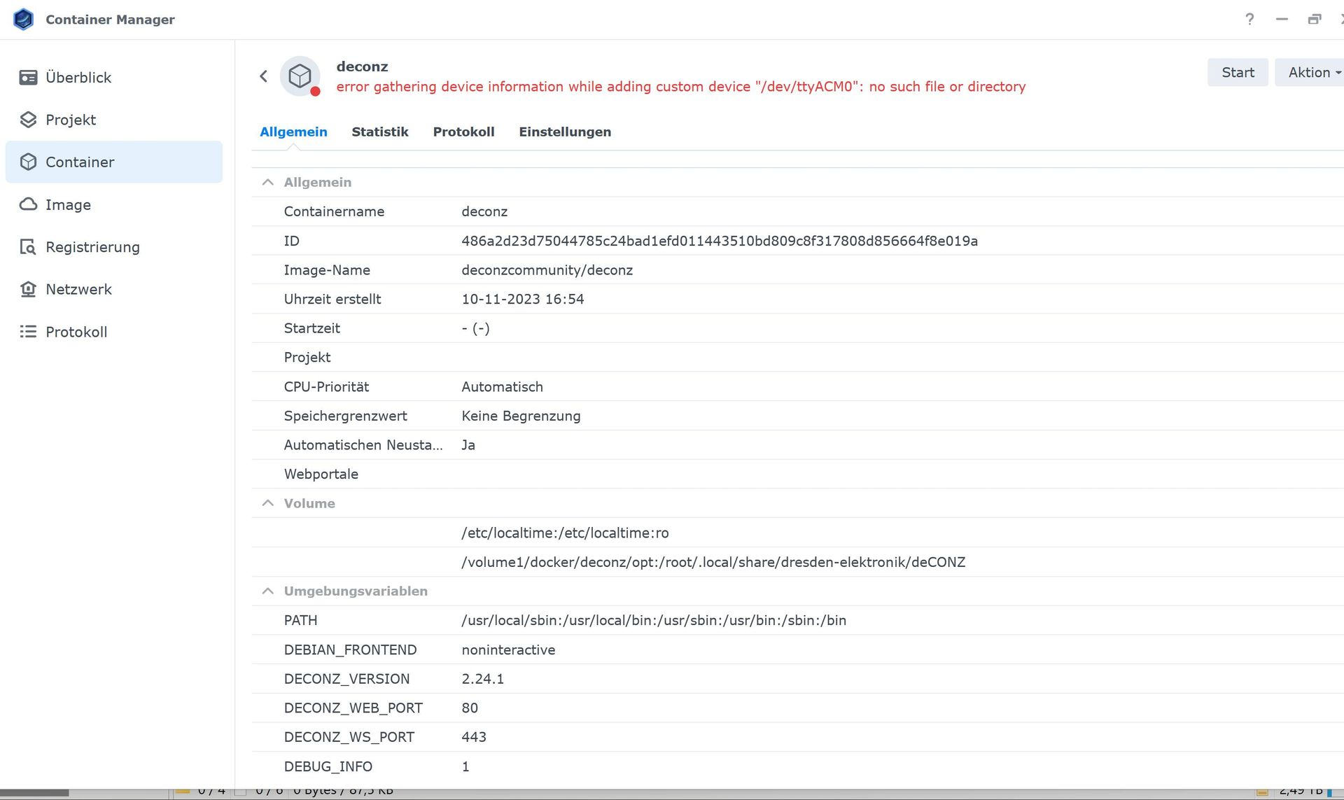

- Run the following command
- sudo docker run -d --name=deconz --net=host --restart=always -v /etc/localtime:/etc/localtime:ro -v /volume1/docker/deconz/opt:/root/.local/share/dresden-elektronik/deCONZ --device=/dev/ttyACM0 marthoc/deconz
- I advise you not to copy the command but to write it by hand to avoid errors!
- Re-open Docker App, under the "images" tab you should see an active container called "deconz", turn it off.
- Select the deconz image and click on "edit", go to the environment, on the parameter "DECONZ_WEB_PORT" type the port where you want to have your deconz server running.
