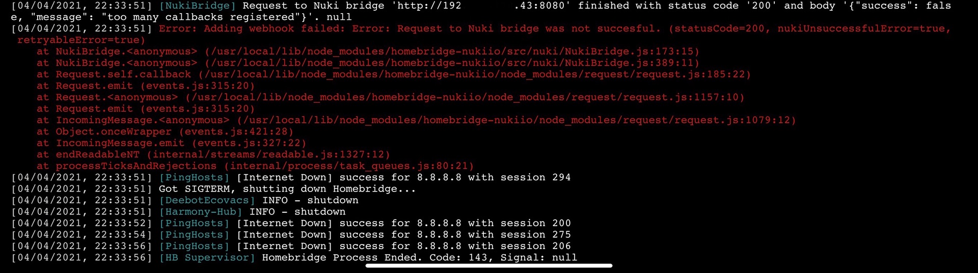

[04/04/2021, 22:56:20] Error: Adding webhook failed: Error: Request to Nuki bridge was not succesful. (statusCode=200, nukiUnsuccessfulError=true, retryableError=true)
at NukiBridge.<anonymous> (/usr/local/lib/node_modules/homebridge-nukiio/src/nuki/NukiBridge.js:173:15)
at NukiBridge.<anonymous> (/usr/local/lib/node_modules/homebridge-nukiio/src/nuki/NukiBridge.js:389:11)
at Request.self.callback (/usr/local/lib/node_modules/homebridge-nukiio/node_modules/request/request.js:185:22)
at Request.emit (events.js:315:20)
at Request.<anonymous> (/usr/local/lib/node_modules/homebridge-nukiio/node_modules/request/request.js:1157:10)
at IncomingMessage.<anonymous> (/usr/local/lib/node_modules/homebridge-nukiio/node_modules/request/request.js:1079:12)
at Object.onceWrapper (events.js:421:28)
at IncomingMessage.emit (events.js:327:22)
at endReadableNT (internal/streams/readable.js:1327:12)
at processTicksAndRejections (internal/process/task_queues.js:80:21)
[04/04/2021, 22:56:20] Got SIGTERM, shutting down Homebridge...
